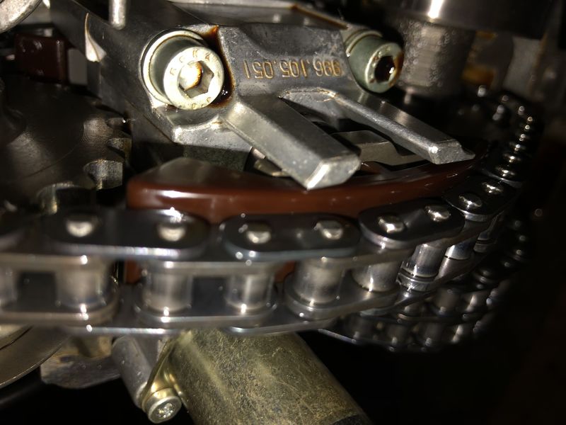

This is where I'm at at this stage. It's as far as I can go without Special Tool 9632 to compress the VarioCam solenoid. (Actually, I could remove the cams and set them on the workbench, but I couldn't do anything with them without the compression tool.) I also need bolts for the camshaft retainer tool, since bolts don't come with the kit. I assumed I could use a couple 10mm cam cover bolts, but they're too short.
At this point I can't detect any wear at all on this pad. In fact, it looks almost brand new.

The pads in this engine are made of a brown material, which I understood is the new, improved material, replacing black pads made of the softer, more wear-prone material. That, and the apparent lack of wear, leads me to wonder whether they've been replaced. I didn't see any signs that someone's been in there before, but perhaps they were extremely careful.

I had another look at the pad through a lighted magnifying glass and still couldn't see much wear when I pushed the chain aside. Wish I could see the bottom pad, because they generally have more wear than the top pad. As long as I'm wishing, I also wish I knew if the engine had any cam deviation. If indeed the pads are the newer type and have almost no wear, it wouldn't make sense to replace them. I guess the only way to know for sure is to pull the cams and have a closer look. If the pads are fine I'll stick the cams back in and leave bank 2 alone.

JFP and other folks who've done this procedure, do you see anything wrong with my reasoning in my last two posts?

My only comment would be that you have come this far, you have the tools and the new parts, and the engine is out and accessible; this is the time to do any and all of the maintenance that becomes a real pain when the engine is back in the car, which could also eliminate any regrets later.
Here is a slightly fuzzy picture of the pads from my 3.2 S engine,
You will notice that one is almost like new and the other, on the right side, is worn to the point where the roller part of the chain is wearing away the pad between the lines where the links run. All the pads I've changed are this colour, like yours, and the new pads are more beige/white colour.

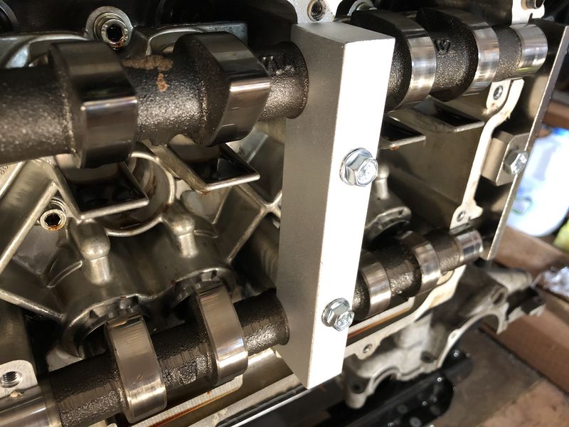

The cam retainer is now retaining the cams, with the help of a couple 10mm M6 bolts.

Thanks, Grant. The solenoid compressor tool is supposed to arrive tomorrow and then I'll take the cams out, remove the pads, and snap a photo of them. The new pads are a lighter color, as you point out. I note the pads from your 3.2L engine look almost black.

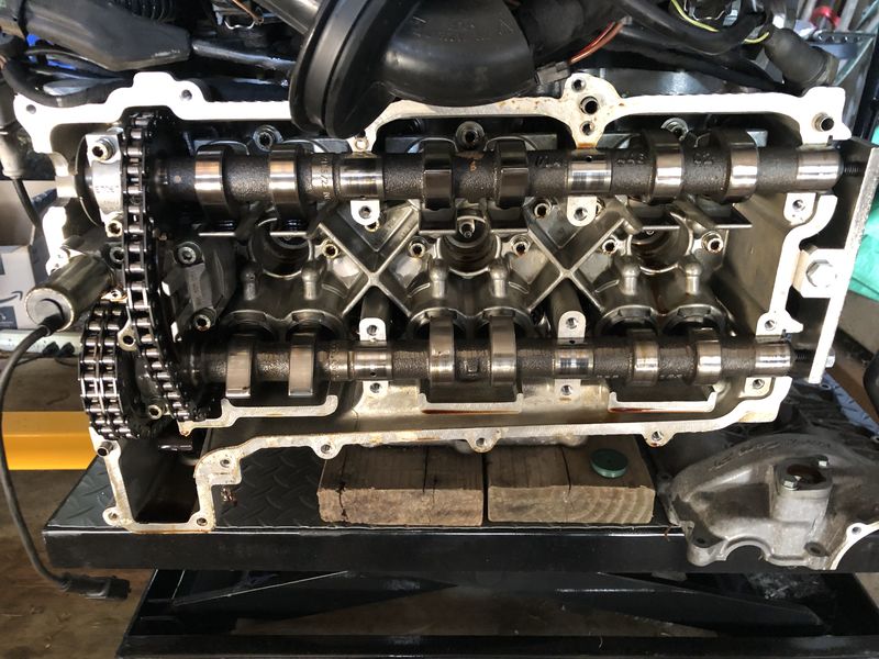

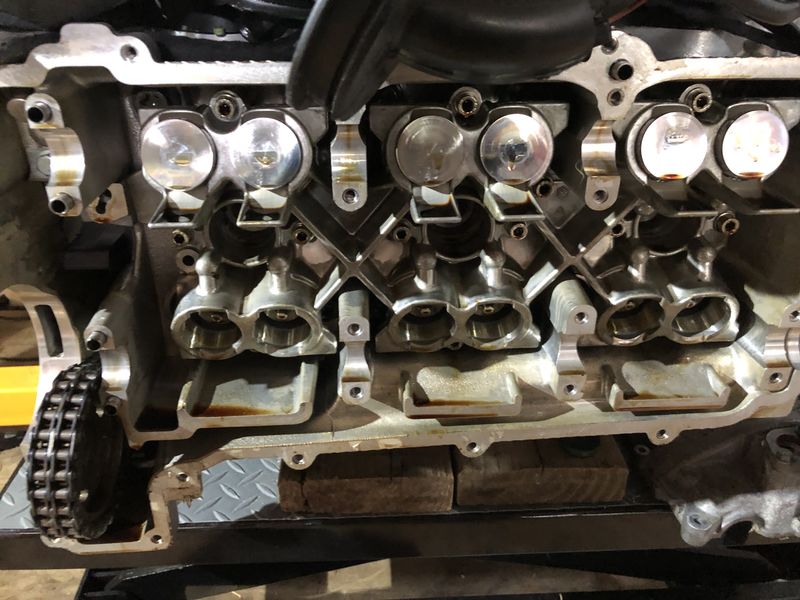

The bank 1 cams are out. Removal was easy and, for the most part, peasy. The exhaust cam lifters wanted to slide out, but I had a helper standing by to prevent it. I removed the lifters one by one and arranged them in order on the worktable. The cam caps and all the bolts are in labeled baggies. Without the compression tool to loosen the cam chain I can't inspect the condition of the bottom pad, but the top pad is more accessible and looks almost new. So there you have it.
Big advantage of an engine stand is that you turn the engine 90degrees so you are working with cylinders vertical and things don't fall out of the head!
